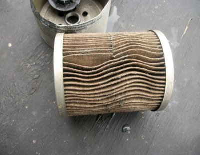

first (wix[napa]-blank) filter @ 7-8k miles on chip truck.
