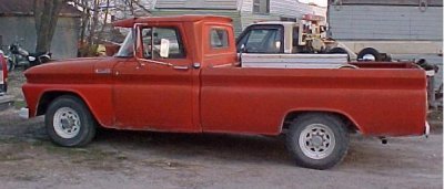

Profile...
I gotta do something with that damned ugly side box.

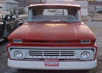

another 1...
For those of you that can't read really tiny and blurry, The tag says,
"Eat More Possum
North American Possum Breeders Association"

Looking at the side shot, the poor 402 is going to be trying to exhale through a drinking straw. lol
Very nice looking truck though. I agree with your Q-jet comment. Are you going to upgrade the brakes before towing that 5er? I would not want to do that with early 60's technology 4 wheel drums, not to mention single reservoir master cylinder.

Re: Profile...
I have sen quite a few done with a differentcolor below the body line....... It would look sweet red and white.... With some shiny wheels..

Damn Ggg, now I got another problem to cover.
The brakes always worked great on it, but If I get in a jam, discs would be great. The only problem with that, is that the 62 has a hydraulic clutch, so the clutch/brake master is one unit. I guess I could engineer a mini hydrovac unit, and slap on a set of later hubs/spindles. If I'm not mistaken, I can use the later ball joints, and its pretty much a bolt-up deal, minus plumbing.
Hell while I'm at it, that would be the perfect time to put power steering on, too.
Oh ya, by side box, I mean side tool box.

:rotflmao :rotflmao :rotflmao
I just spotted what you were talking about on the exhaust Ggg. Those pics are before, with the 6-banger still inside.
I thought you were refering to my unscrewed torsion bars on the front end. That is 12 turns down from stock height, by the way.
I haven't decided what to do with the exhaust, yet. I do a little custom bending for the diesel shop here, so access to a bender is not a problem.
