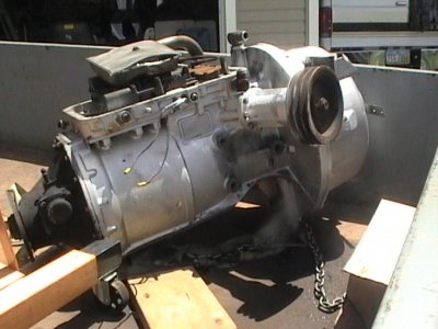

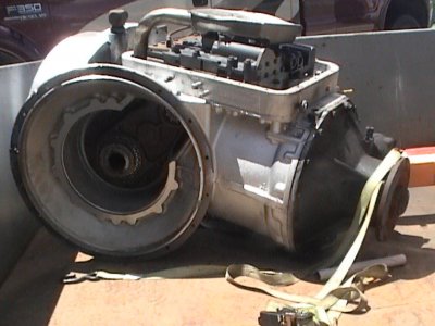

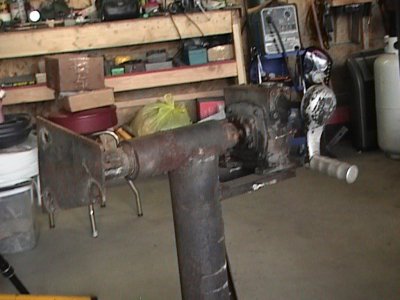

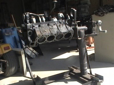

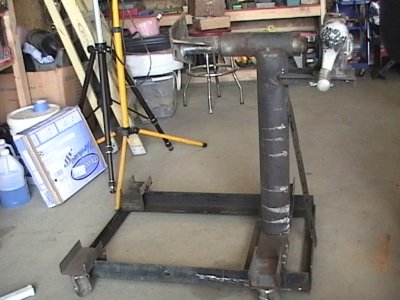

Here is one that I made back in 1990 in a hurry when I was rebuilding the Allison V730 transmissions for the GM 4107 busses and others that had the crosswise engines. Worked just perfect for me. Those trannies weighed 1300 lbs.
The verticle pipe is 4". Gear reducer is out of a chicken coop chain feeder.
1st two pics is the V730 setting in trailer ready to scrap.
2nd two before I changed to engine stand.
3rd is after change, hanging is a 7.3 IDI

Nice custom built stands. The one with the levelers front and back... Please adjust the rear ones with the weight on them. Lifting the front ones at the ends of the leggs can flip the load. Nice idea too. Now if towcat will just post a pic of his Rotunda engine stand you guys will be impressed. Those were made so the engines can be bolted to it by the side motor mount machined areas or from the back.. It also has a gear reduction drive to rotate the engines. To say it well built or heaveily built is an understatement.. It neededs a crane to lift it in or out of a truck...
