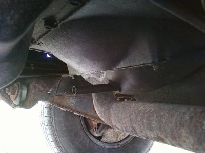

Have a 94 E 350 with a 7.3 IDI and E4OD
Started leaking tranny fluid from bell housing cover. first through a tube on bottom of cover, then a lot coming out all around cover.
I was told it could be front bushing walking out and pushing seal out or "pump capsule" venting when hot.
Any ideas?
Just got the van, only put 1000 miles on it.
It's a short school bus with 130k on rebuilt tranny.
Is this drain tube welded to the botom of the flywheel cover stock or is this a mod? If a mod then it must have leaked before which is an issue. But bus company seemed to be honest good guys.
Sorry i am not of much help but i do know that the tube is stock.

Can you post a photo of that tube? I've never heard of anything like that before.
My best guess based on what you're describing is that the front seal has failed. It can be due to overheating, dirt tearing the lip, or the bushing in the transmission going bad.

Failed pump seal. It could be from a worn pump bushing. It could have failed from heat.
There is a Viton replacement seal available. Precision #16601EV. You can find this seal at a good parts store.
Some of the E4OD's have a drain tube welded to the dust cover. Most don't.

and thanks for the replies. I'll try to get a pic of the tube if you still want it.
