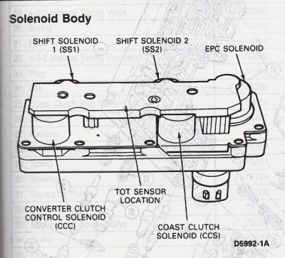

342
Have you checked the connection on the pass side of trans itself? There should be a shield there to keep the heat from the exhaust from melting the wires. If you remove it, don't pry it, squeeze the locking tab and pull up with the wires.

I got in there earlier and cleaned it up, one of the first things I did. I flushed it till cleaner ran clean, blew it dry, twice, then greased it....however I did not visually inspect my work. I'll be getting down in there again hopefully Monday and put my eyeballs on it
