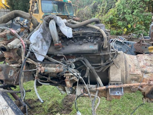

interesting thread. sorry if I resurrect it. going to look at a dt360 and 10 speed trans this afternoon, but he says its a 1985 model. thats the door that was on the truck at least. I missed out on one of these in august with a 6spd on the back. trying to make sure it IS a dt360. pics he has up aren't very clear this was the best one.

Looks like a 466 from the pic. The valve cover has a dimpled rib in it from what I can tell. The 360's had raised ribs on the valve cover. The 466 is still a swap option on the Superduty generation where they have more room under the hood.
There are also a couple of 360 builds including mine documented here in the conversion section.

well it was a wasted trip, it was a dt 466. too early in 1986 buld date to be a 360. I scraped some grime off and found a 210hp on it >was the lowest number on the tag>or what was left of the tag. I was a little dissapointed , but when I got hoem from the trip I posted a wanted at for a DT or DTA360 on kijiji.
