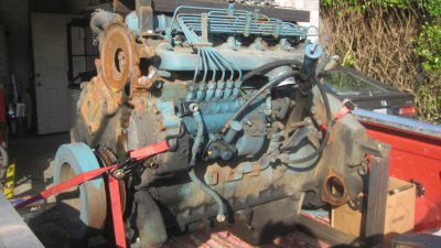

Just noticed you said the water pump was too high to mount a mechanicle fan. All the DTs I've seen from the dt360 to ht570 the fan didn't mount to the water pump the water pump was on the lower passanger side of the front cover just woundering if yours is difrent.
bike-maker
Oct 19, 2008
1,168
albany, OR
Check the pic below - water pump is obviously missing, but you can see the top of the water pump is just barely lower than the top of the valve cover.
681
Man o man.. Look at all 6 of those injector line clamps. Must be some shakeing going on there. Nice looking engine too. Even nicer looking lifting bar on top of it...:sly:thumbsup:

I say 4" body lift so the fan shroud will match up with the pump.
