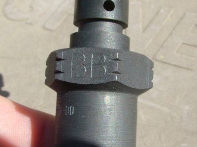

I just recently had Russ (Typ4) rebuild my IP and I bought a set of Delphi injectors (code BB) from him. The difference was remarkable. Another problem has cropped up, but that is totally seperate from the IP and the injectors. It turns out that I have a critter farm, with many, many algae living in my fuel system. :puke: That will be worked on, hopefully corrected, next weekend.
If you want new Delphi injectors, code BB, talk with Russ. He has them at a reasonable price, and he pop tests them to be sure they are good, and to be sure they are matched for pop pressure. And, equally important, Russ is a forum member you can trust. For me, that trust is as important as the fact that he sells a guaranteed good product. Be aware, though, Russ is going on vacation in a day or so. I suspect he's not shipping anything until he returns.
Delphi injectors are marked by code. I'll try to insert a picture of mine. There are more pictures in "My Photos".
