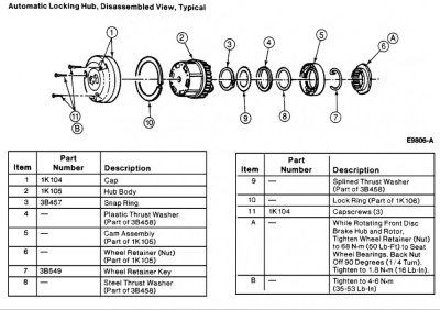

Howdy folks, have a 93 f-250 with the Dana 50 auto lockers I took apart the other day and noticed one side is missing half of the cam for the locking mechanism.
Parts counter workers have been no help and exhaustive googling has been no help.
I'm wondering if there are any resources to purchase individual pieces of this or am I stuck buying the entire auto hub assembly? I also plan on calling around to scrapyards.
I have this exploded view I found , in which what I need is #5. Thanks in advance!

I would recommend installing manual locks. I couldn't find much info on parts for the autos.
Edit: I found some comments on other websites, guys complaining about the auto lockers failing, specifically the cam ring. Apparently Ford used to sell a repair kit but no more. For the cost and reliability it seems like it is preferred to install manual locks (Warn or MileMarker).

This^^^^ ditch them. First thing I taught my son about the truck was how to lock in the hubs. ;Sweet
The Warn premiums are nice but overkill if you aren't ******* stuff. I think you can have a set of mile markers for around $100 and then it's all new.
