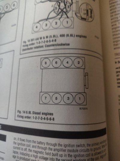

I'm replacing my injectors and I'd like to label each old one for which cylinder it came out of.
How are the cylinder #s referenced? I didn't find anything in my shop manual.
Austin86250
Oct 5, 2021
841
490
idaho
cylinder 1 is bottom left, cylinder to is bottom right, third is 2nd from bottom on left im sure you can fill in the rest
