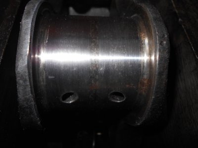

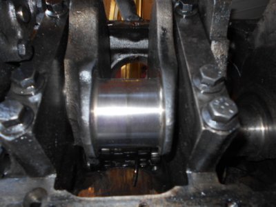

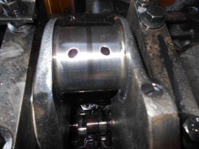

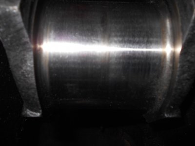

Here is the crank I have that your interested in, sent you a PM but no pics are allowed in the PM's. That is all four throws.
