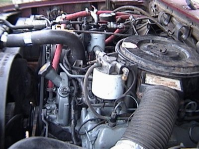

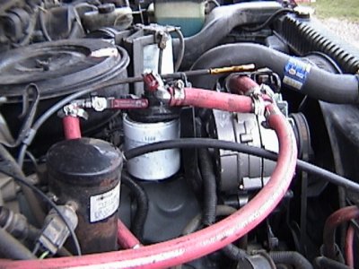

One more thing off the list of needs to be done list.
Yep it's in the Beef if y'all wondering about the van fuel filter head on the motor. :Sly
I used the van fuel filter head of my '91 donor motor and kept the old mounting hardware off the truck fuel filter head and put the coolant filter assembly in its' place. ;Sweet
Only things that needed to be modified of course was to use the IP to filter hard line and I had to tweak the air cleaner tabs underneath to allow the filterhousing to rotate back about 3/4" to make room for the van filter mounting bracket. The stock air tube still had enough play to remain hooked up to the core support. ;p
Ron ;Really

Figured if it worked, it was better to try to keep the parts on the truck as to keep the spare parts piles down to a few piles in the corner of the shop. :popcorn
Ron :draw
