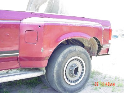

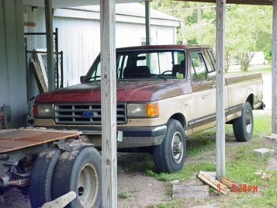

My parts truck was converted you want the parts? The bed is gone but all the rest is there.
