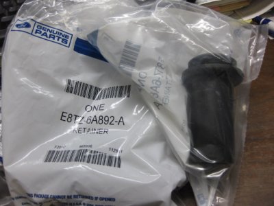

I don't know what your issue is. just for S&G I went ahead and called my local ford parts house and gave him the exact part number I posted for a quantity of four. this is what I got today.....

sorry for the confusion, maybe this will help. the bottom parts are what came off my truck, the top is what i ordered. i am looking for the smaller hose/gasket(one piece) in the middle that attaches to the back of the cdr, not the larger bottom hose that goes to the valve cover.
1,442
you have an ATS aftermarket turbo system on your truck.
trim the bottom tube to fit.
the top tube/grommet is NLA from ATS. I am in the process of replicating it as we speak since I need one too.
