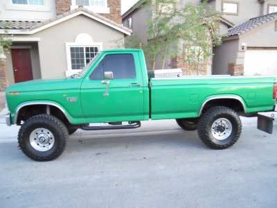

tell me how to post a pic and I will gladly let everyone feast their eyes on what my girlfriend has dubbed "the dirty pickle"

I think I attached the pics correctly.

Pics are up sir, enjoy the dirty pickle!!!
