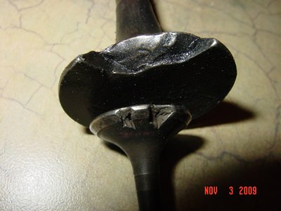

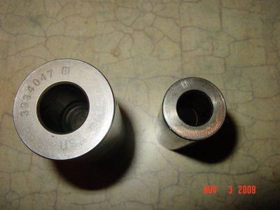

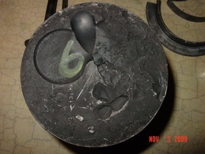

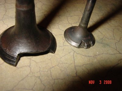

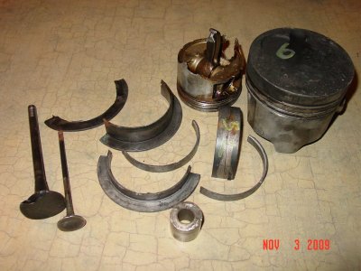

Here are some of my s-1600 carnage pics. The valve is #6 exhaust, smaller valve is from a D15 Honda. Some split and spun main bearings, as well as my broken wrist pin.
Edit: The smaller piston is from the same D15 about a week after rebuilding the head.

HOLY CRAP MAN! Please dont show me those. God I don't want to think about what my poor brand new turbo looks like after some of those missing pieces ran through it. Oh it makes me want to cry!

I am not to sure about the split bearings. Best I can figure is that the motor was run with water in the oil as I found too much rust on things like push rods and a few other parts. The bearings also show signs of getting hot which is directly tied to lubrication issues. The valve let go due to a combination of high EGT and being over spun. All of the above was done long before I owned the truck. I broke the wrist pin, and believe it to be defective.
I bet your turbo is fine. You should check it though. When my valve let go it sounded like small gravel beating against the fiber glass hood of the truck. My ATS Garret turbo had a couple of slightly bent blades. I was going to run the turbo as is but I had the HY-35 laying around so it was just too tempting!

I know this thing was turnin some RPM because every piston shows valve contact.LOL
you sure the clearences werent just too tight cause icanfixall said on his origanal motor i think the first one he built that burned down every piston had a spot were the valves kinda kissed the piston just enough to leave a mark but not enough to cause any real damage
