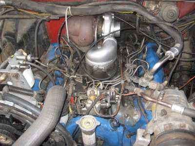

Well FINALLY got the intake spacer to fit. I should have had it made another inch or so taller and wouldn't have had any issues with needing to cut out the upper land to clearance the compressor housing. I also had to clock the compressor housing around to the back, which I think will work better in the long run anyway. It was the only way it was going to fit so hopefully it clears the firewall.
There are no local dealers that carry silicone couplers of any kind much less elbow
couplers so I purchased a short 90* 2" radiator hose and it works perfectly. I really don't see having any problems with it for a short term use. So you can see the radiator hose back there and the 2" pipe piece is actually a cut section of the fuel filler neck from a parts truck. Works great too. I had to leave the breather section in there but I don't see it causing too much trouble for the short term either.
Aside from jacking the cab up and cutting the transfercase shifter hole in the floor I'm ready to put this thing in the truck. Crossing my fingers to have it in there and running tomorrow.

Only problem is I see a clearance issue with your turbocharger because of the way you pointed/routed your compressor outlet. That line is pushing into the firewall zone. Can you rotate it down some more? There really isn't that much room between the firewall and the circular part of the compressor housing.

The next clocking point sets it straight down into where the bellhousing would be. I'm not sure if I can move it down there or not. I guess I could try. That radiator hose flexes quite a bit while holding its shape, because I left the spring in there. So it can move. But does it sit so close to the firewall that even the turbo flange may run into the firewall?
I'm more than willing to take a 10lb sledge to the firewall but if it isn't going to help then it's not worth it.

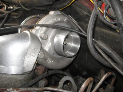

Put it to you this way, Sean. I can't squeeze my girly little hand between the turbo and the firewall in my truck. Now my compressor is a little bigger, but not by enough to really make enough difference here. Even if you didn't have to think about the hoze coming off the turbo outlet, you still wouldn't fit the turbo in that position.
If you look at the turbine housing, you can see how there is a sloped flat area on the side that is against the firewall. That was so close in my truck that for the longest time, it would rattle against the firewall until I finally figured out what was going on. DROVE ME BONKERS FOR MONTHS!!!!!!!:mad:
Seriously though, ATS stuffed the turbo as far back as they possibly could. I would almost suggest wielding up a metal U pipe and then use a hose to connect to that instead if you can't find a hose that turns tight enough after you rotate the outlet to point at the tranny.
I've got some photos I can post later to show you how close it really is. I'll see if I can get them up later tonight.

Yea if you've got some pics David that'd be great. I've only got one crappy pic of a 088 system in a truck and it doesn't really show how close it is. I'm almost tempted to take a torch to the firewall. I'll go clock it down and post pics of it like that.

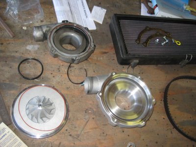

These pictures show the turbo kit after the 60-1 compressor was installed, so I included a shot that shows both the old and new one to get an idea of the size difference - which isn't really much considering what you have to clear in there.
Hacking the fire wall might seem like an easy way out, but the problem is you are actually going to run into the drain gutter seam so simply bashing it out of the way isn't possible because the metal is backed by a rather strong seam joint right there.

Well this one had better work or I give up. I think I just screwed my compressor oring clocking it this time. There's a spot in it that I can definitely tell its been flattened or something, its definitely out of shape and I don't have anywhere to go to get one of those unless the service dept at my IH dealer is open tomorrow and they can get me one. God I hope it seals.
Anyway I had to file down the compressor housing lug to clear the hat this time and had to change my IC piping a bit but that radiator hose and fuel filler still work great and I think it'll clear this way. If it doesnt I'm gonna get mad real quick.

I think I still have the old seal from my original compressor. If you can't find anything locally, I can try and send it to you for the cost of mailing it. Unless its actually cut or really pinched, you will probably be fine though.
That should clear the way it is now, and there is also a decent amount of room on that side of the engine to allow for routing of the hot side IC line. Since you don't have the original cold air duct anymore, you have at least a 3" zone to shoot through if you need it. Looks like it will still clear your glow plug controller, injectors, glow plugs and return lines;Sweet
