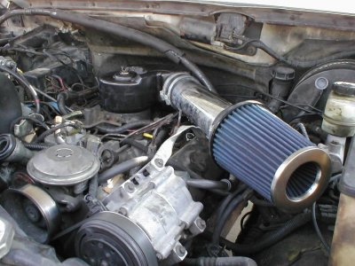

Ghost Tube as requested...
...It's actually an open element filter system by air raid that fits 2001 dodge p/u with 318.

Turbo69, whats the block off plate installed on the front of the intake (or rear) and ip adaptor in ur pic gallery?
notice much improvement with the "ghost tube"?

Was the black piece that screws onto the manifold fabricated by you, or part of the Airaid kit?

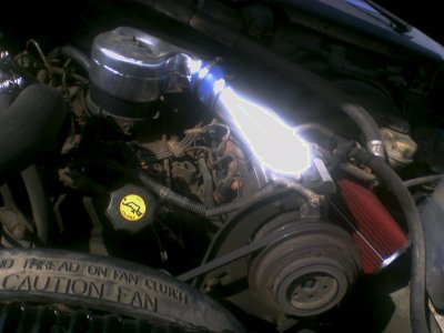

Excuse the crappy cell phone pic, it was the only thing I had on me while I was loading hay last night.

I was looking at my cowl area by the wiper motor and such, i dont understand how hypermax's kit works. i dont have any room anywhere on the cowl to locate the air intake kit...my vacuum booster is HUGE (compared to my F-150s).
i like the intake Zigg posted with the stove pipe...i may go with that style.
