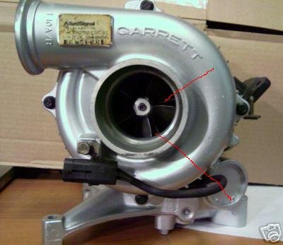

Take a look at the turbine, it looks like it's sustained some damage. I am not certain but the painting thing leads me to believe that someone is making a silk purse outta a sows ear ..... so to speak:puke:

From those pics, I don't see what you see in the turbine as far as damage... The compressor wheel looks just like mine, the irregularly spaced fins are normal (for that one). The second one you list is for a 99+ 7.3, the third one is from a 94-97.
I'm not sure how those hook up to an IDI, but if you can get that, even a rebuild kit for these is fairly cheap, if there is problems....

OK I am no picture editor so just bear with my edit.....
Look at where I drew lines and what they point towards...the one blade lower one looks like its distorted on the outer edge....the other blade looks as though it sustained damage and has been perhaps filed or altered. IMHO doesnt mean its hosed or no good....the inner picture is poor and does not allow for a real good view.

I think I see what you're saying...
You are right about the picture being crap. Hell, for all we know, it could be missing the other fins.

I personally can't tell squat from that pic but on the positive side it costs less than $200 to rebuild a PSD turbo including a new compressor wheel and balancing if you do the rebuild yourself......It's about the cheapest think you can fix on a Powerstroke.
