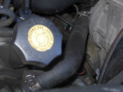

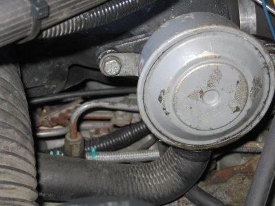

One thing I 're-engineered' on mine that you might want to look at is the hose and mounting for the CDR. Banks has it mounted with the inlet pointing up on the side of the airbox. That allows the CDR to hold a certain amount of oil (and vapor that eventually condenses) and when it reaches a certain height the accumulated oil will flow into the airbox. I mounted the CDR so the inlet points down so it will not hold any oil. I then cut the hose that runs from the CDR to the adapter on the timing gear cover. I installed a hose mender and rotated one end of the hose about 180* from its original orientation. WHat this does is provide a 'slope' from the CDR back to the adapter so that any oil that accumulates will flow back to the adapter and eventually into the crankcase.
Here's a couple of pics so you can get an idea. The hose clamp you see behind the AC compressor is where the cut/mender is......
