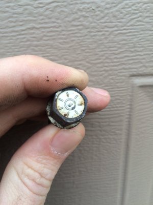

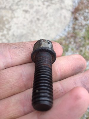

Dana 60 bolts from a 1999 E350, up close and personal
