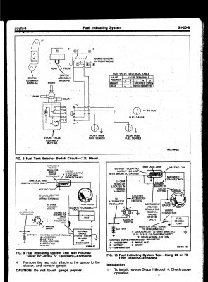

This might help.
That's the wire diagram from the manual.

Here is the circuit diagram. If you still have the tank selector switch, leave it switched to the rear, do away with it and the wiring.
On the FSV connector, splice #4 (Orange wire) and #5 (Brown/White) together, check the colors, I may be wrong on them.
CVR = Constant Voltage Regulator.
Wire colors on the FSV conector.
#1 = Y/LB
#2 = Y/W
#3 = DB/Y
#4 = BR/W
#5 = O

No. The wire color list in post #5 appears to be in reverse order. Brn/Wht and orange are terminals 1 and 2, for the selector motor/solenoid. Jumper those and you'll blow the selector fuse. You want to jumper the SIGNAL wire from the rear sending unit to the signal wire to the gauge head. That would be yellow/white and yellow/ltblue. Or terminals 4 and 5 on the connector.
