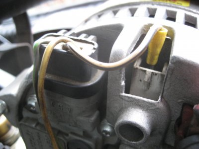

On top of the alternator there are tiny wires. Three in a connector clip and one of those wires goes to the other single connector. It's that single wire connection that may be causing your problem. Try wiggling it or better yet splice in a new connector clip on the single end. IIRC that wire goes to the stator and if not secure your voltage will fluctuate.

When I changed my alternator, the plastic clip on the wire broke. Now, it will not lock into place. Didn't work properly, until I took a small piece of cardboard and shoved it next to the connector. Makes great contact now and works great!
Better yet a $.15 female spade connector is the real fix. That's what I did.

Here's mine. The view is from the back. It's an aftermarket 200 amp alternator but it takes the exact same connectors as the stock one does.
How often does a real fix cost $.15? ;Sweet
