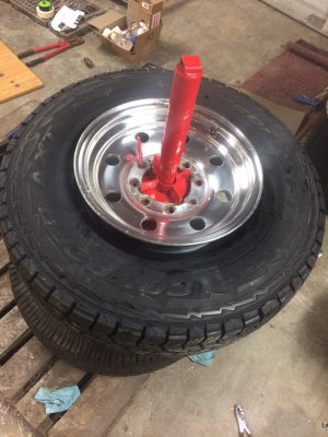

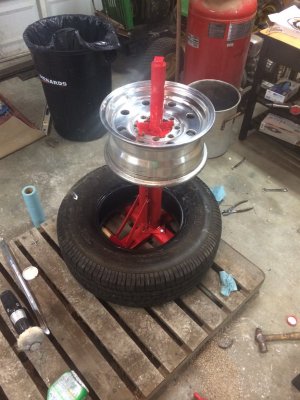

That's why I just started doing them myself. Summit has free shipping on good tires. Valve stems are $0.59 at O'Reillys. Tire changer was $40.
It's $12/tire around for a dismount/mount at a shop. Made penciling that red changer pretty easy.

Is that the Harbor Freight tire changer? I have been considering it myself.

Yep. I'm planning on doing a quick tool writeup for it. I'm pleased with it so far with the 4 tires I've done.
