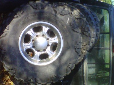

Heres the scoop
-93' f-250 4x4 7.3 IDI N/A (using frame/drivetrain, and e4od transmission with less than 5,000k on it)
-94' f-250 2wd 7.3 IDI Factory turbo (using turbo, body, and interior)
-89' 7.3 IDI N/A (full rebuild, new crank, pistons, etc)
So as far as the build goes
-Sand blasting/painting frame
-Swapping over the body and interior onto the 4x4 chassis
-New front fenders/cab corners
-Coat of gloss black paint
-4" Rough Country Lift, MKW M-25 rims on 315 Toyo Open Countrys
-3" Downpipe to 4" straight pipe to dual 5" mitre cut stacks
-BB Code Injectors for now, then upgrade to DPS Stage 1 or Moose Misters
-Crank the DB2 up a turn or 2
-Auto Meter EGT and Boost Guages Pillar Mount
-Homemade air intake with BHAF
-ARP Head Studs
-Inline Coolant Filter
-All new U-joints, seals, and bearings
So what do you guys think? Any input and suggestions would be much appreciated!
