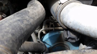

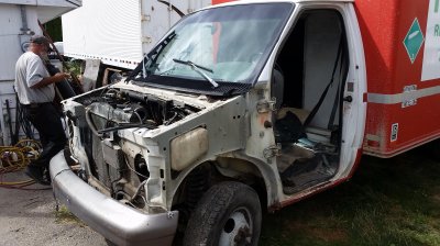

So with everything going on...Brian is parting out a cube van to make into a trailer.
We are popping cab off and pulling emgine.
If engine checks out ok...its sold.
Other parts available...
Should be a great project.

Got cab off no big issue.
Next is fire, run, comp test and done!!!

Took plasma cutter over to Brians to blow the 6 body bolts and such...was easy peasy...
That engine will be tested this weekend and then sold or scrapped....if scrapped....core material.
Told it runs good by my friend...so hope so he moved to BC with it and it seemed to run fine when we had it going here.
Trailer will have an AC unit stuck into it and used for hanging a deer.
Lots of fun.
