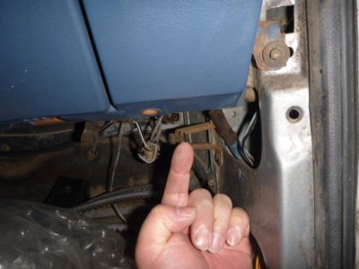

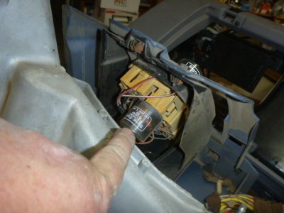

92-97 hazard flasher location.
just a note for those looking for their hazard flasher.
It's on the backside of the in-cab fusebox. see pics.
it's just like the flasher on all 83-86 models.

On my '95s, I just (ahem) reach around behind it and pull it out. On the '85, I have to remove the bolts that hold the fuse box in place and shimmy it around.
Right under the dash on the left in the fuse box. 4 plastic retainers on the cover under dash and Bob's yer uncle (to quote riotwarrior).

wrong. what you see on the driver's side fuzebox is the turn signal flasher.
in the bricknose, the emergency flasher is nowehere near the fuzebox.
anybody else wanna guess? :D

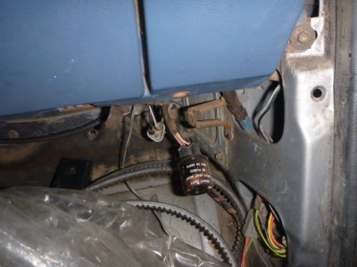

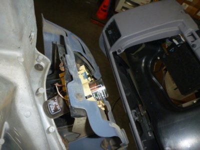

Oh a brick the horn relay is about centered on the firewall behind the dash.
Calvin, is it behind the glovebox?
close. It's to the right of the glovebox, mounted right above the passenger side kickpanel.
