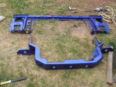

You can swap lower hoops. I peeled mine apart to straighten it. I believe it's just drilling out the spot welds. I know there is a thread somewhere here on doing it that way. Ron maybe? It was a blue truck so that is always my guess. :D
Yep, that's me. LOL
As said the gasser core supports can be used for the non AC diesel short, wide radiators. The tall narrow radiators require modding the gasser core supports as seen below. It's just a matter of drilling out the spot welds and a little grinding, some cussing because you missed a spot weld and a few beers and they'll separate into two pieces.
