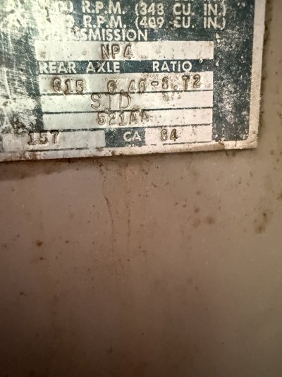

Thanks for the info. Here’s the plate on inside of cab
Grumpy bruce
Aug 19, 2022
Ca
You will be happy . I put a 6.9 in a 77 GMC. That was in 1986. I didn't stick with a Ford transmission so I had clutch problems. other than that it ran great. 355 gears GMC four speed
