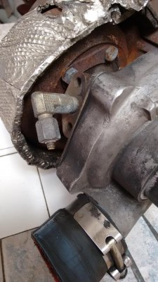

just bought this banks turbo last night, know that i need a y pipe and a u pipe but what else do i need?
turbo part number is 24920 any info on the your experience would be great!
plan on doing a 1-2 inch body lift when i go to install the turbo so i dont have to hammer the firewall to much.
truck is a 1991 f250, got about 189k on it right now, just replaced the injectors have a boost-pyro-trans temp gauges.
zf5
tired of hearing and feeling my truck struggle for air, i need more power:sly
here are some pics of the trubo.

intake hat or other means to get the air into the intake manifold, air filter, 4" exhaust, pedestal or other means to mount the turbo and drain oil back into the engine, CDR relocation, and maybe some other small things im just not thinking of right now.

that generation Banks turbo uses trans specific Y-pipes. When you are sourcing for the pipes, you need to be specific on what kind of auto trans or what kind of manual trans.
