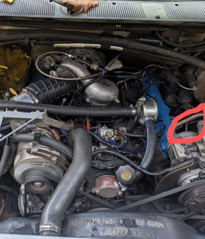

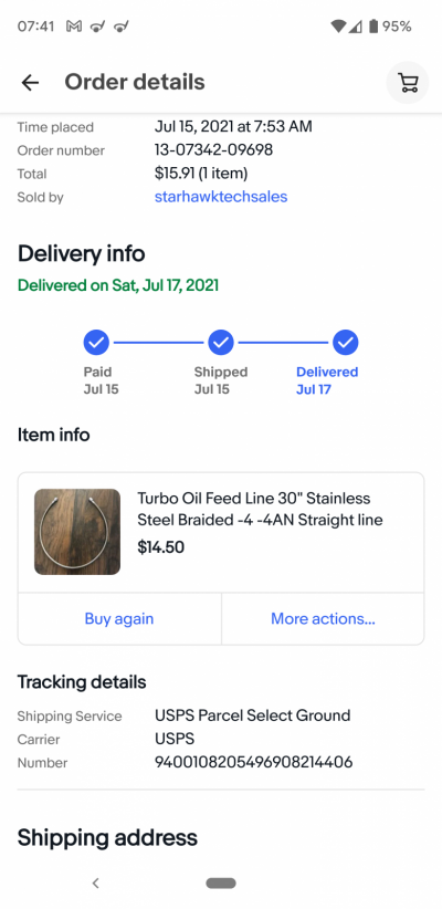

I purchased a 30 inch oil feed line and the appropriate -4 an fittings. One for the block oil feed and one for the turbo feed block. I used a 45 degree fitting on the block riser. It will be either 1/8 npt for a NA block or 1/4 npt for a turbo block. The turbo oil manifold I'd either 1/8 or 1/4 depending on direction it faces as it can be reversed pointing the sensor to the passenger and feed to the driver.
I ran another 24 inch line from one of the 1/8" galley oil plugs on the driver's side to a remote pressure switch for the aftermarket gauge. I used the stick sender on the turbo as my idiot light. If it reads anything, I know I getting oil to the turbo. The remote sensor reads the true pressure from the block instead of at the turbo.
Pic is the feed line I purchased for the turbo. In the engine pic you can see the routing of the oil feed line and the circled remote line below the AC line. It's barely visible.
I just didn't like all the fittings hanging off the oil manifold. I don't know how well the brass fittings will hold up with the engine vibration.

Wow. I hadn't thought about that and also am a bit leery of a brass manifold and engine vibration.
The back of the head is a nice idea but not so nice if something goes wrong with that connection in the future. I might split the feed off the back of the block and run a second flexible oil line to a remote manifold not mounted on the engine.
