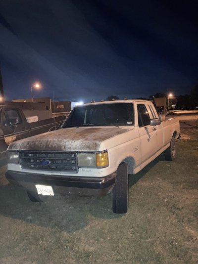

Hi I’m new with owning a diesel (1990 F250 7.3 idi) and I was wondering how to hook a aftermarket oil pressure and a coolant temp gauge up on it . Is it easy or a decent job. An how to do it. Thank you
