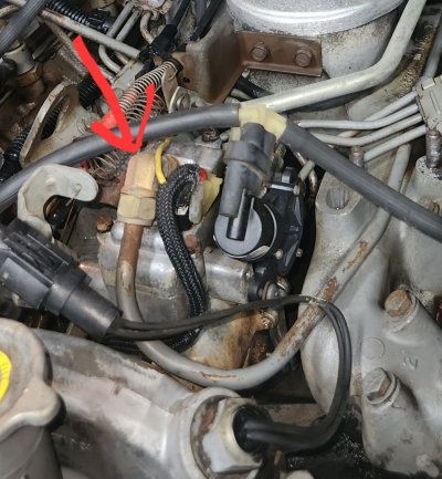

It's on top of your injector pump where the return comes out. It's the piece that actually screws into the pump. Post #11 has a picture of it on the left side.
2,677
2,817
Never changed the pump. Changed fuel and air filters that were due. Glad I checked that check valve.
Oh I thought I read somewhere that you changed the pump.
None the less, glad you figured it out!

That brass elbow screws into it.
Gotcha. Thanks for taking the time to post that.
I replaced my pump last year. I didn't know about that valve. And I don't know if a clean one came with my "new" pump or if I'm still running an old crusty one that I reconnected to the new pump.
My truck is running fine but I'm wondering if I should check that valve to see if it can run better.
