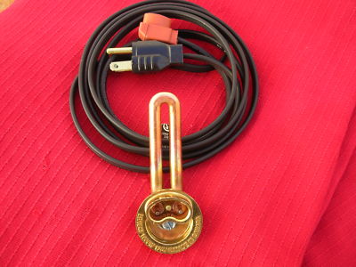

Get a tank type that goes in the heater hose. They have a thermostat so will be lower operating cost overall. The stock type just stay on as long as they are plugged in. Or use a timer as previously said.

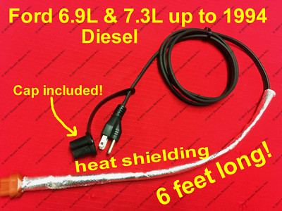

Yeah, the BH is 1000W, is on the Passenger side next to the Starter.
It will for sure warm the engine for quick starts from the coldest of nights. They do not heat the engine oil, just the Coolant.
Price has gone up a bit, paid $50 for the last one.
Here is a cord if any one need`s one.
Make sure the cord is zip tied away from moving parts.
