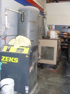

200psi on a 6.5gal tank is a toy.
run it.;Sweet
the vertical mounted tank in the pic below is what a bomb looks like.
