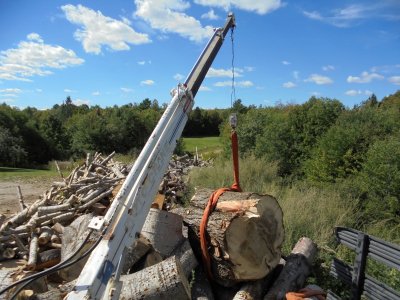

a properly functioning 130a 3g alt should be pumping out 100a.......at idle.:cool
http://www.fullsizebronco.com/forum...26658-3g-alternator-facts-its-wins-agian.html
with the factory 130a 3g in both my trucks i can;
chip truck;
plow snow with electric cooling fans on.tilt the dump bed up/down if needed to transfer weight to rear wheels for added traction,listen to the radio with the amp going.
log tuck;
use the auto crane all day long,so long as the truck is idling.
(without truck running,the cranes battery will go flat inside 10 mins)
i have never been in want for more juice with either truck.im not claiming you may need more than i need but odds are high if your not doing things like this and your current 130a isn't keeping up,than you just need a replacement.
