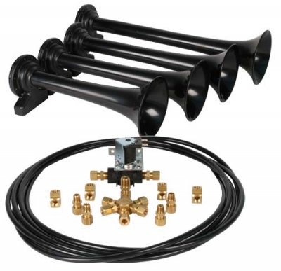

Hey Warden,
Here's one from the buell site that is lower pitch but, it is not exactly low profile - nor is it cheap.... They have quite a few sigle horns too. All trumpet type though that you can listen too. This one is a fancy chrome quadraplex horn though....
http://www.buellairhorns.com/buell-quadraplex-air-horn-c-3-p-1-pr-16135.html
Here's a single 15" that is somewhat low tone too....
http://www.buellairhorns.com/buell-15-air-horn-c-103-p-1-pr-16161.html
Here's a five horn rail horn too that seems low tone....
http://www.buellairhorns.com/buell-5-chime-rail-air-horn-c-75-p-1-pr-16150.html
