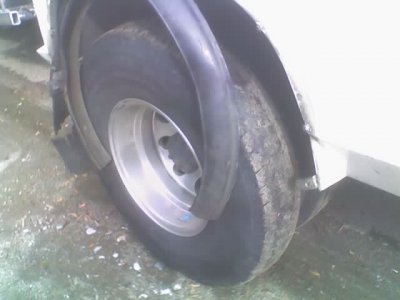

Oh, another thing too real quickly while I'm on the subject of tires... when I pulled off the front wheel I noticed this cracking around most of the inner part of the tire. How serious/dangerous/bad is this?
look at the two pics. that is what will happen to the tire you posted in the pic. btw, the casing was still at 80 psi. mime "was" ****** rubber. that truck was forbidden to run caps due to CHP contract.
