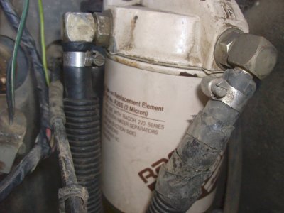

The water separator? Would that be the Racor water/fuel filter unit? It is a 220 series, having taken it out completely to clean it I don't remember there being any wires in the unit. It is tan/beige in color, is that stock or not?

here's a pic of the water/fuel filter. Thanx for the help

what you have there isn't stock.
the stock water seperator looks like a aluminum cylinder. the "water sensor" plugs in on top.

If the water seperator wires aren't connected to anything, will it cause problems? should I make jumpers or just leave it as is? thanx again Calvin.
jesse-
only if you like looking at those pretty red lights.
otherwise, leave it alone. If you do go to a 7.3 filter head setup, you'll have the basic wiring there to work from to make the light work proper.
