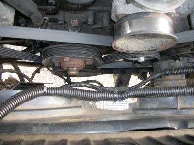

but with just a little mod/fab work,you can ditch the stock shroud and mount them directly to the rad.this is how i did it.even just enough room for the larger motor,or install them upside down for increased room.

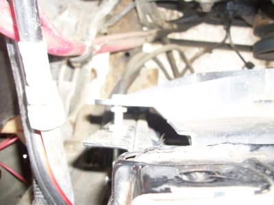

once you grind the shroud a little bit flatter (i think it was just a bit off he top- notice my rough grinding work/gaps? lol.) there is just one tab that is not a direct bolt on deal.it's the upper pass side.easy solution posted in pic.adjust this,so fan has plenty of clearance from the rad,and your ready to wire 'em up with your favorite controller or relays.
start to finish 2 hours max.difficulty rating 2 out of 10 (10 being the hardest.)
