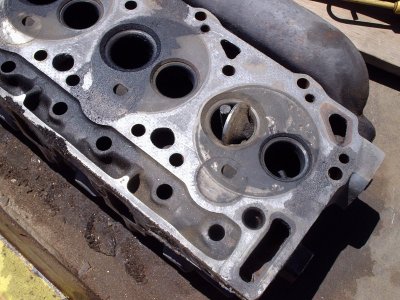

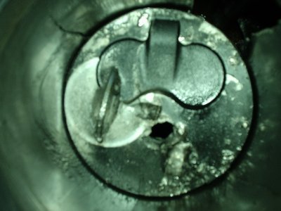

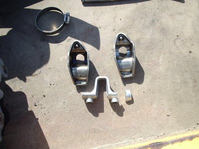

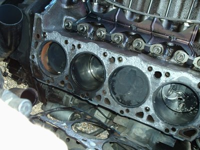

Also, be careful to tighten them evenly, especially if you have the older style aluminum bridge rockers. I lost a freshly rebuilt engine from uneven tightening of the rockers.... :eek: (rocker pivot cracked at one bolt, cracked off loose half worked free so rocker was only supported on one side and was tipped which held valve open and after kissing the piston enough times it broke off and caused serious carnage)

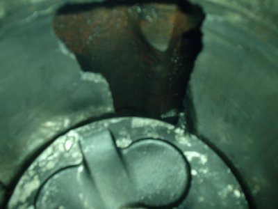

Well, on the other hand the truck made it ~100 miles on the freeway at about 15k gross (admittedly flat) with a 1/2" hole through one of the pistons before loosing the wrist pin..... :eek: Was still running after that too, though it lost oil pressure from dumping the cooling system into the oil sump.

Whoa....that was ugly...no my rocker arm bridge is different than the one in the pic....
That's the newer style - much better than the aluminum bridge both because it's not going to crack like mine and less wear.
Yep, fun trip. Just got done with the engine too.... had reasonable warning something was going wrong but the point where I realized it was something more serious (had a serious chuff and pressure fluctuation but though it was a simple valve issue) was about 100 miles into a 400 mile trip pulling horses, and I couldn't really stop and figure out what was going on but had to just keep going and pray. Made it ~100 miles after that (with piston kissing the valve), then another ~100 miles with the hole in the piston and finally died 80 odd miles short of home... but was relatively easy at that point to have someone come rescue the horse trailer and get AAA to tow the truck to the shop - 99 miles to the shop and I had 100 mile free towing.
Man thats a thin cylinder wall!
