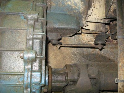

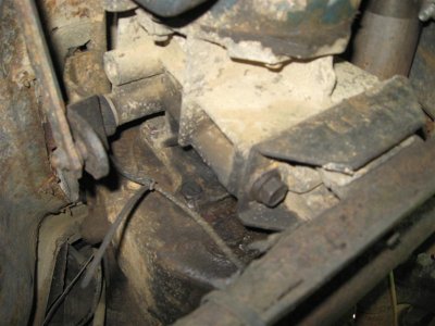

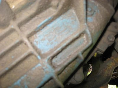

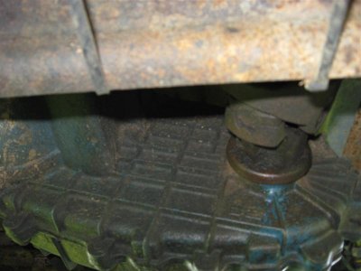

I've been bugging some of the guys behind the scenes about transfer cases. Here are some pictures of what I have in my truck, from the pictures on the Gear Vendors site, which show the 1345 that you have to use their back half of the transfer case to use their OD units, I'm guessing I have a 1345. The rear output shaft does not have a removeable tailshaft housing. The case is clearly stamped BW, and it doesn't look like a 1356, so I'm assuming it's a 1345. Here are the pics (the first is the rear view, the next is the front view, next is from below, then of the BW stamp, then of the adapter)...

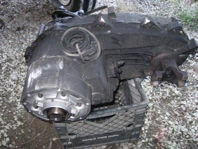

The transfer case I purchased from Brian (Mudbillyrednec) is an NP208 and is the one I want to use. It should only require the adapter from Gear Vendors (I know, lots of money) and should be a bolt in affair (with the right adapter) correct? Here are a couple pictures of it (from a 1986)...

Unfortunately, the adapter on the GV unit I have is the long, 1356 one, so I'm gonna have to do an exchange unless someone has an adapter for an NP208 they want to trade for a 1356.

It does LOOK like a 1345. I am pretty sure mine actually had the number on the case somewhere. I have my fully rebuilt unit available if you want it... and a spare new chain.

With the 1356, it uses a rear slip yoke and the 1345 you have now uses a fixed yoke front and rear. Either way, you'll need a new rear shaft once the gear vendor in on as the shaft will need to be shortend.

first time i have ever heard of someone that wants to use the np208. i have had bad troubles with them in the past. take good care of yours.
sle2115
NRA LIFE MEMBER
Dec 3, 2005
7,147
Southeast Ohio
Just like the gear to gear...never heard of issues with one...what kind of issues?
BigRigTech
Diesel junky
Feb 10, 2007
3,288
Nova Scotia, Canada
I sold an NP208 to a guy last winter, his blew a hole in the case while plowing snow....The two 208's that I had sold fast, yet I have a shed full of 1356's.:dunno...Divorced NP205 under my truck - no chains to break/stretch. -Showtits:sly
