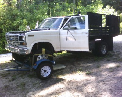

trust me on this....
those Uhaul trailers won't be able to handle your truck. look how little room there is to spare with a MBZ 300d on the back of it.
outside of this guy, I have yet to see a tow dolly accomodate a truck our size on it. your only solution is someone with a trailer long enough to handle the truck.
