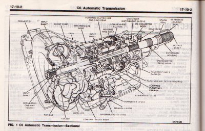

I like what has been posted so far. Being the year it is I'm sure you have a C6 trans. Those are simple and cheap to rebuild or have rebuilt. But do refill the trans and run it. See if the leak shows up. Like already said. Look for the leaks as far forward as you can. Wind will blow a leak all over the rear underside of any car or truck..

Along with what towcat suggested, you should change the oil and coolant. The oil cooler on the drivers side, the O'rings have probably hardened up and should be replaced also. Replace the lift pump, cheap at $26, diaphram in it could go anytime. Replace the "Olives" in the hard lines, one at the top from lift pump to filter and one each end of the line from filter to IP.
If the trans. is leaking fluid out the front, the seal on the input shaft from torque converter is probably it, have to pull the trans to fix that. If that, then a good time to replace the rear main seal. While your doing all that, would be a good time to fill the filter with some Seafoam or ATF, run the engine for 2 -3 minutes and let set at least overnite.

Also pic of C6 tranny.
