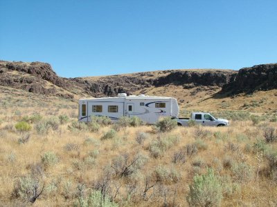

Well, someone on another forum pointed out to me that I used two different scales. that could easily account for my weight differences.
Anyway you slice it, I'm close to being over the GVWR and am over the GCWR. I am well under on my GAWR so all is good. Truck handles the load well and gets about 10 MPG pulling the beast.
