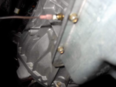

Anybody got a pic of where they installed the temp sender on the Torqueshift for aftermarket gauges? :confused: Just want to make sure I get it in the right place. :thanks:

Originally posted by timntools
will anything come out of it when you remove the plug, or is the oil level below that?
I seem to remember maybe a drop or two and that was it when I installed mine.

Originally posted by Puddle Pirate
Plug is already there. I believe it is an inspection plug. Just take the plug out and screw in your sending unit. No drilling or thread cutting needed.
Thanks for the pic and info.:thanks: Finally got around to putting the sender in........Wow.......what a job! Took all of ten minutes:peelout and that was after 8 minutes of digging for wrenches!:rotflmao :rotflmao :rotflmao
