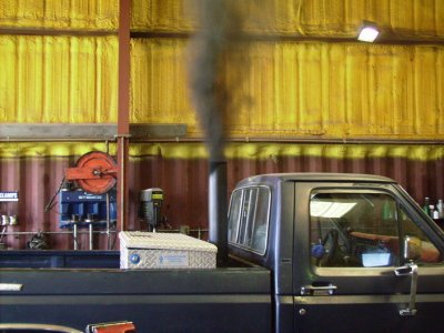

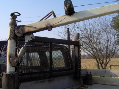

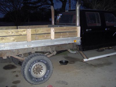

Stack the truck! Be creative in fabbinf up a system to go from stock pipes up to the bed, think outside the box. I bet if you went to a local welding shop and had them fab up a cross pipe out of square or rectangular tubing, you could save $ that way. I am fortunate enough that my line of work has lots of steel pipe involved. I picked thru the scrap piles and found a piece of 6" heavy wall pipe for my cross tube, and welded 4" stub's for my 5" stacks to bolt to. Under the truck coming from the factory y pipe, is 3" straight pipe, to a piece of 3" flex up to my cross tube.
As you can see from my pics, my trucks set up was a little easier to do because of my flat bed arrangement. My stacks are just a hair taller then my head-ache rack and crane.:D

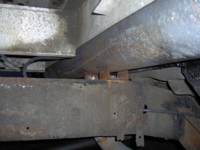

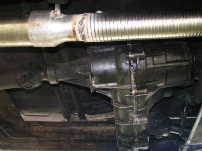

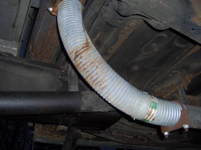

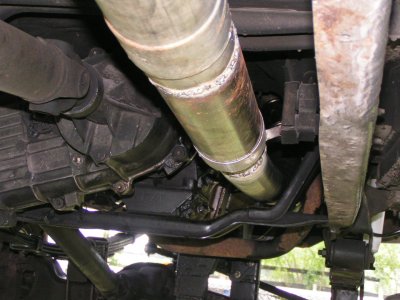

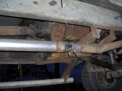

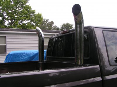

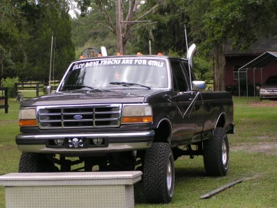

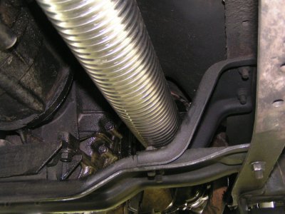

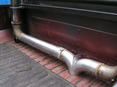

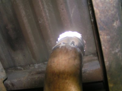

Stacks Installed.......
Okay... pics as promised of my beast..... It took the better part of a day to do all this, well 1/2 yesterday and a few hours this morning. My friend did a GREAT job, seeings how there was a LOT of hacking and welding to be done..... I'm super excited and boy does this thing sound mean now! I'll have to get a video clip, my batteries were too dead though.......:thumbsup:

you don't waste much time prettying up the ride do ya? But it looks really good:thumbsup::thumbsup::thumbsup:
Looking at the underside of the truck shows the oil leak was found. the motor wanted to rust-proof the entire running gear.:eek:

hehe Thanks, i was so excited when we fired it up!!!!!!!! There is still a little bit of an oil leak i'm on the hunt for, it's not coming from the turbo either since we had to swap the downpipe and all..... I'm not sure, i'm gunna clean it off down there and keep a watchful eye for now.....
