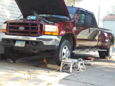

I like the one with the expanded metal behind. Centurion painted mine and it's peeling.
I need new headlights too, mine shines Yellow, can't clean them, color is inside them.
