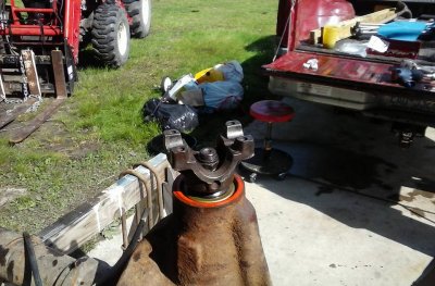

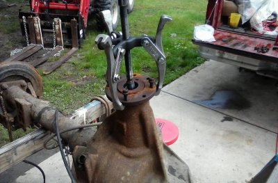

The SD flange came off like butta compared to the 95' 1350 flange.

This flange took heat and a big hammer. That was after it broke a three jaw puller! It was tough going on as well, I think it would stay on without a nut on it. But she got a lock tite nut anyway. :D

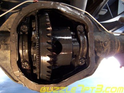

So I opened the cover to let it drain over night to be welded in the AM an found this, It looks like a limited slip but when you look through the little holes it is just an open carrier...that has no room for welding! Has any one here welded a 10.5?
