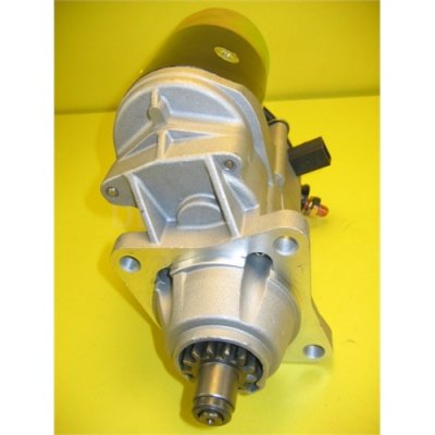

Replaced my started little over a year ago with the one in the picture. About six months ago when I would turn the key over you would jus hear a click, try it again and it would start. Well now today when I turn it over it just clicks every time I turn the key over. I cleaned all battery terminals, starter connections, tested batteries and they both are good showing 12.2 volts each, and I even took the starter down to Autozone they tested it and it tested just fine. However, it is still just clicking when I turn the key, any ideas???
